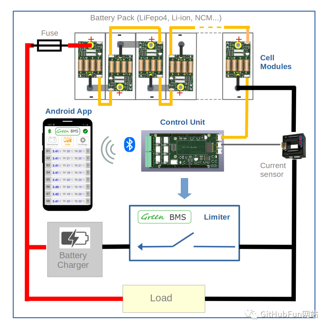

Smart BMS 是一款适用于锂电池(Lifepo4、Li-ion、NCM 等)电池组的开源电池管理系统
https://github.com/Green-bms/SmartBMS
BMS的主要功能有:
  • 保护电池免受过压影响
  • 保护电池免受欠压影响
  • 平衡电芯
智能BMS由四个主要部分组成:
  1. 单元模块(https://hackaday.io/project/181453-green-bms/log/198376-green-bms-cell-module
  2. 控制单元(https://hackaday.io/project/181453-green-bms/log/198414-green-bms-control-unit
  3. 保护器(https://hackaday.io/project/181453-green-bms/log/198378-green-bms-limiter
  4. Android应用程序(https://hackaday.io/project/181453-green-bms/log/198377-green-bms-android-app
