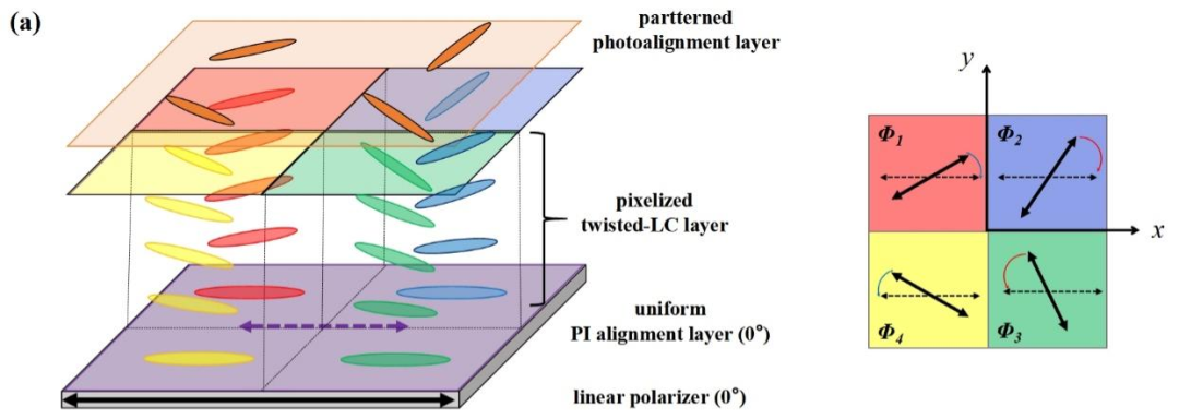

The proposed LCMP array consisted of a pixelated twisted liquid crystal (LC) layer and a uniform linear polarizer. Based on the polarization rotation principle of twist nematic LC, the twist angles were designed to be ± 22.5° and ± 67.5°. A large birefringent LC material with independent intellectual property rights of the group was adopted to obtain the optimized polarization efficiency.

Figure 1. Schematic diagram of a superpixel in the LCMP array (Image by ZHANG)
